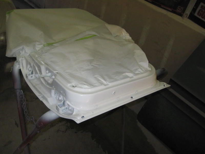

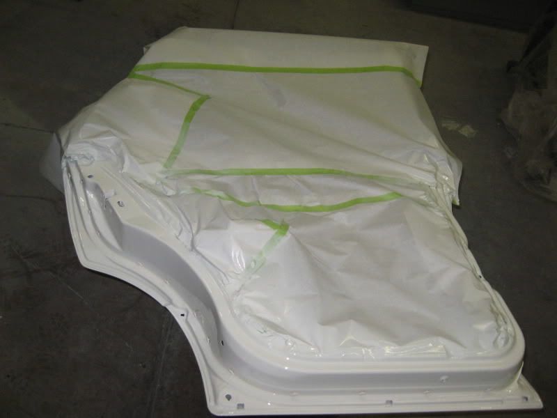

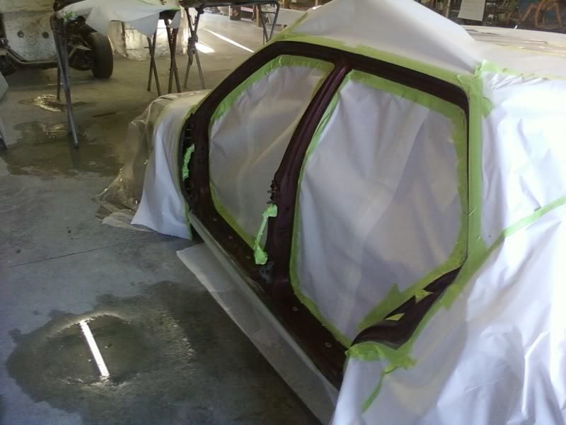

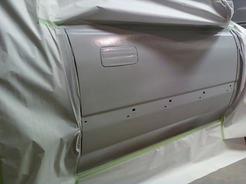

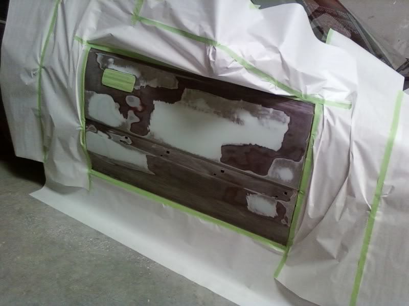

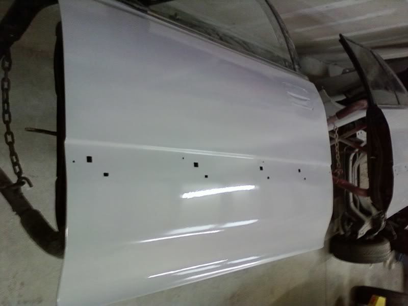

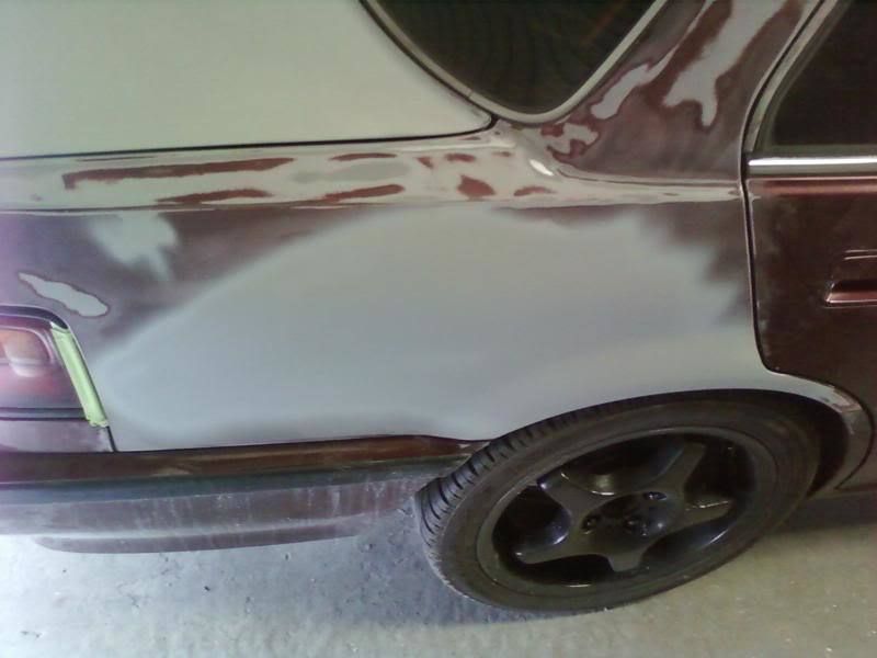

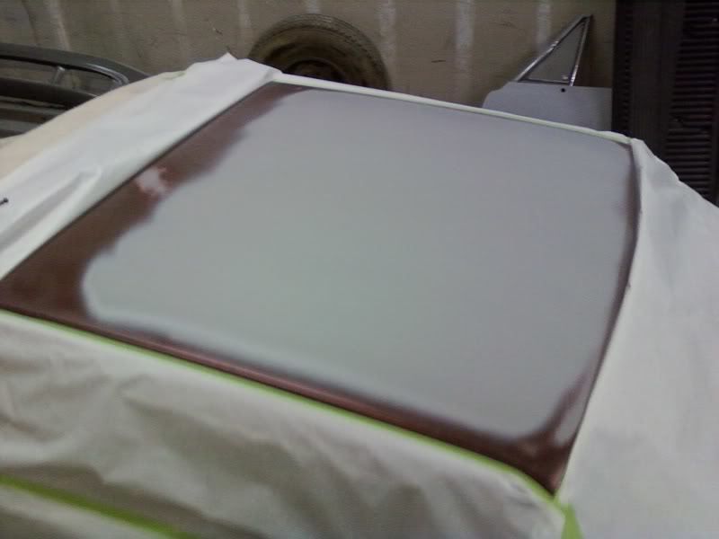

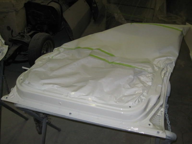

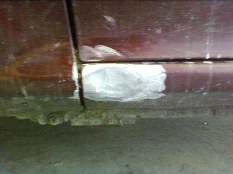

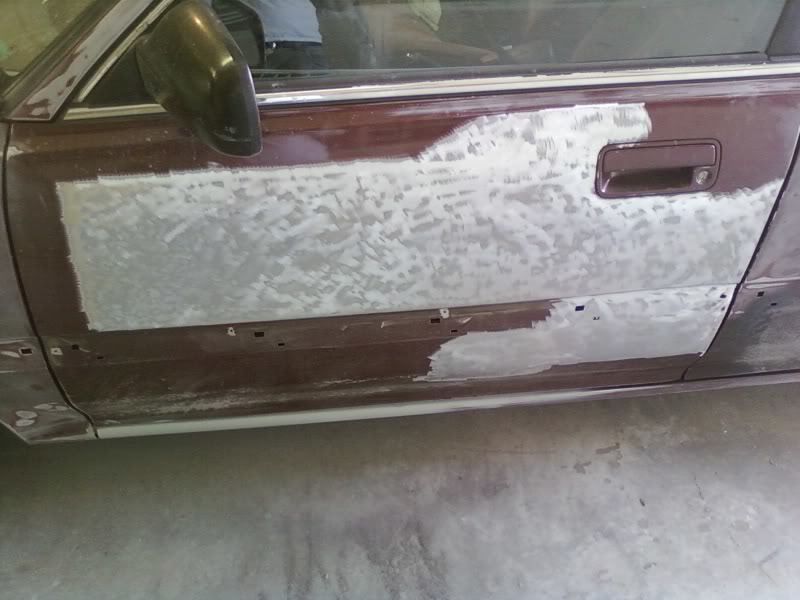

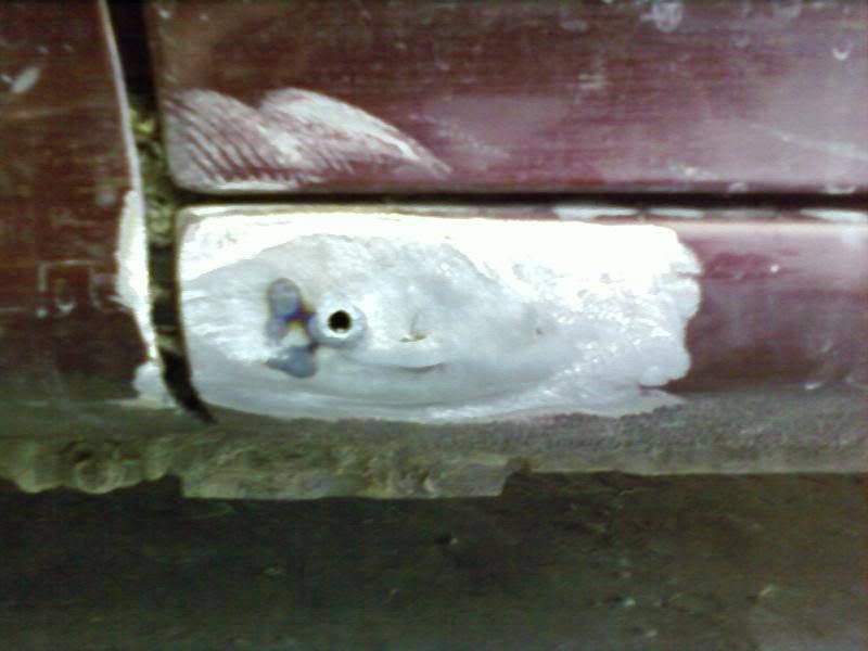

Thanks everyone for the replies Its good you love pics cuz I usually always take tons lol. More than necessary, But Im the same way and when Im lookin through a thread it makes me want to read more when there are a lot of pics. Today I guide coated and blocked both those doors again, And found that the middle body line washed out for a few inches where I filled it in, So I sanded it a lil and layed down a piece of tape below the body line, Added filler sanded it straight guide coated, sanded added filler, guide coated sanded, and vualla its a perfect body line peeled the tape and now gotta re prime that spot Tomorrow Im going to start on the front passenger door, and HOPEFULLY finish the filler work on that door tomorrow too. Lol This time I have learned my lesson, DUMP the filler on and block it away, Lol, No more lil filler here lil filler there a million times lol. Might jam my car tomorrow too, Depends on this boat we just painted today, wether or not the owner still wants the graphics over the beautiful lamborghini orange.

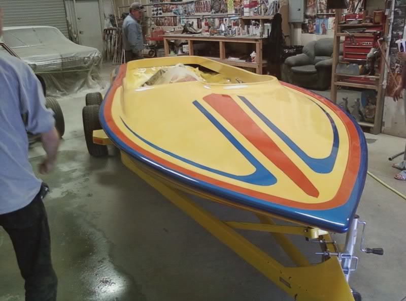

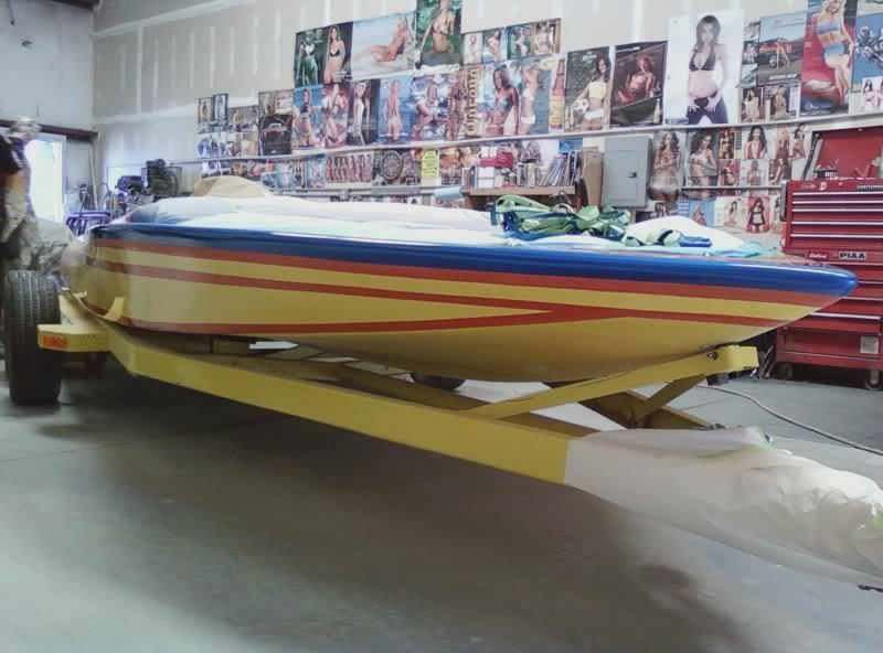

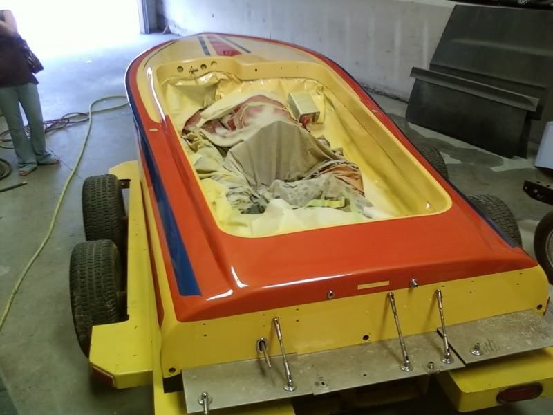

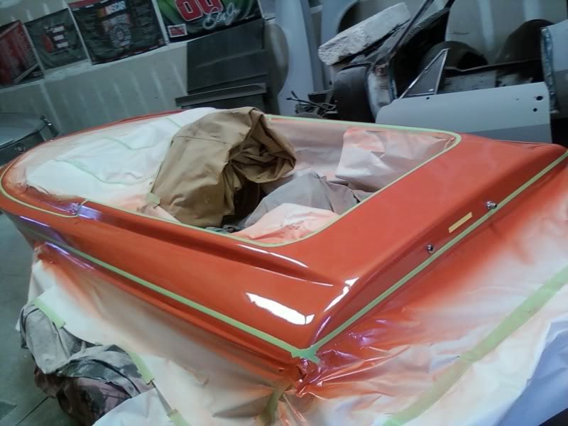

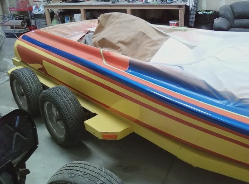

Whatcha think? Theres yellow with yellow pearl in the masked sections, And on the bottom theres lambo orange graphics, Same with the bow. A lil sapphire blue in there too, Ill post finished pics thursday or friday when its all done

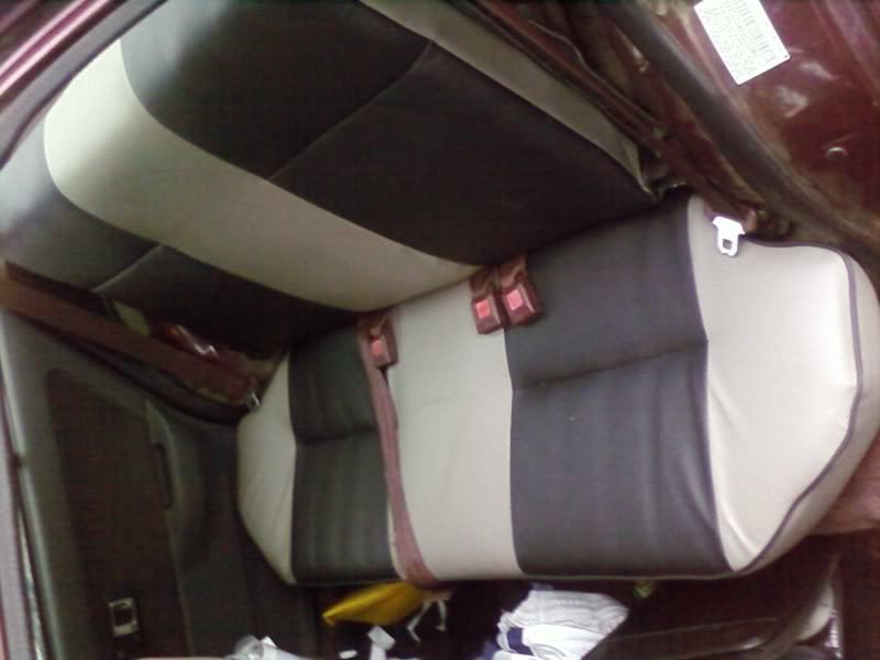

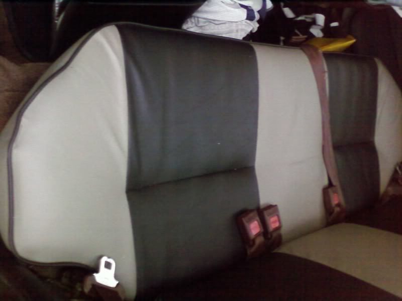

I painted all the interior pieces of my civic. I did not smooth anything. I cleaned everything really well with paint prep, then 2 coats of adhesion promoter then I base coat clear coat to match the exterior, it turned out well. The adhesion promoter helps a ton with plastic pieces unless you are using paint with flex additive.

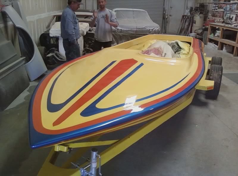

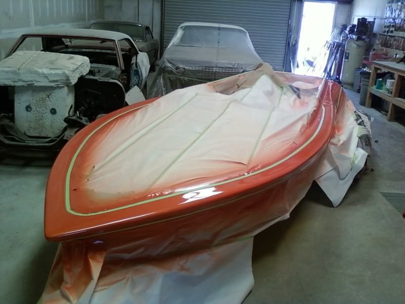

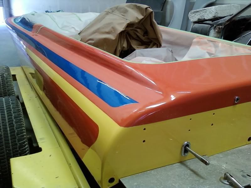

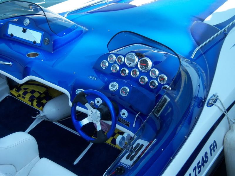

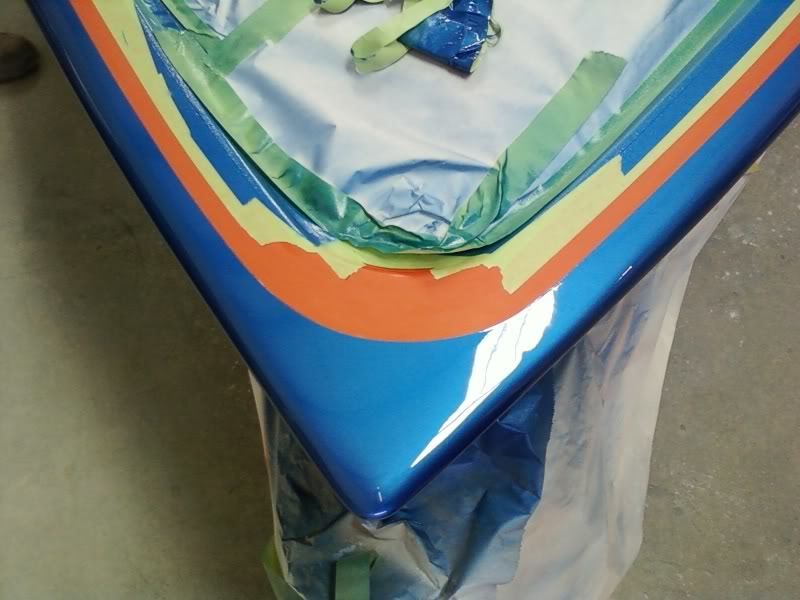

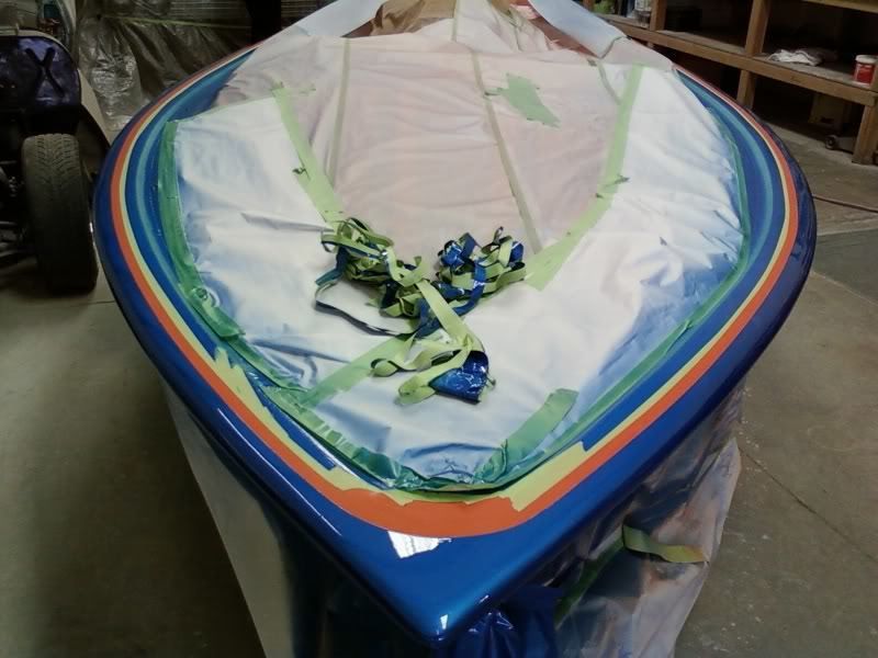

Quick update on the boat..
slammedyota91's avatar
slammedyota91
The dull orange, is due to wetsanding to lay the blue down, Now gonna wetsand the whole thing, Paint the yellow on the bow, and clear to whole boat again

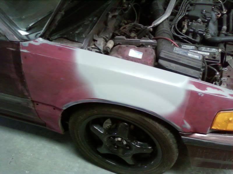

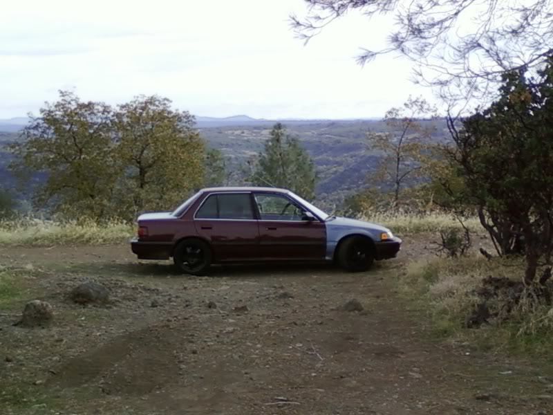

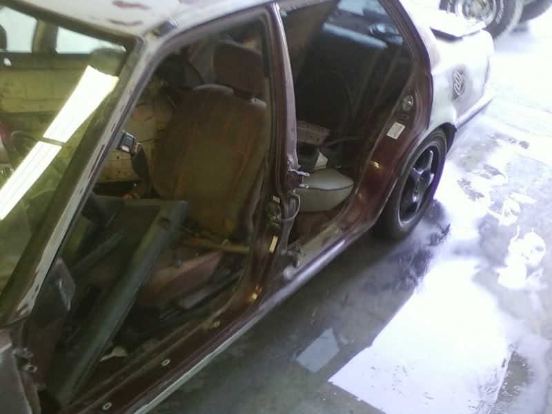

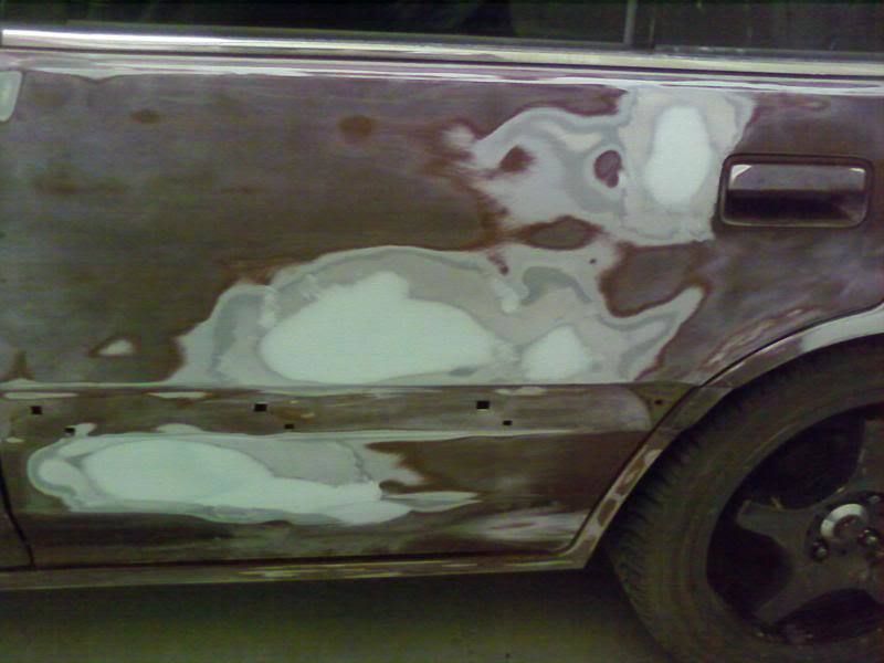

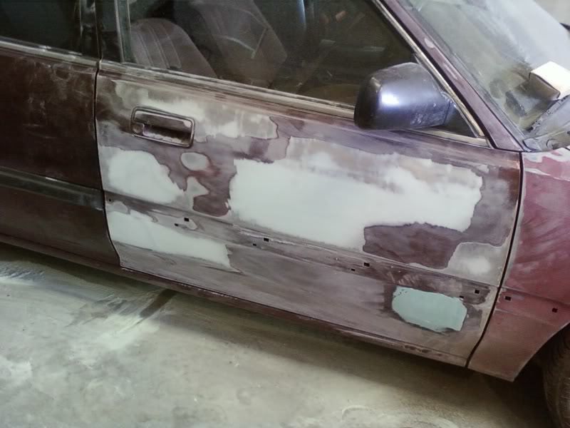

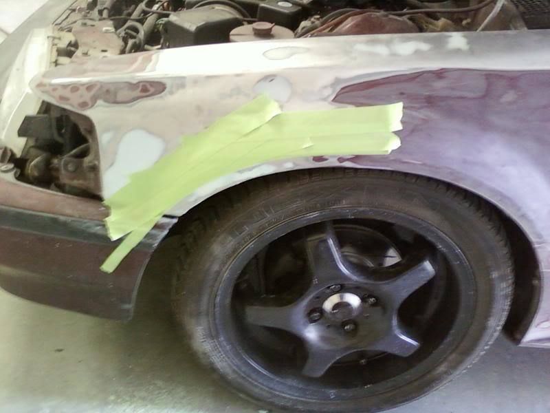

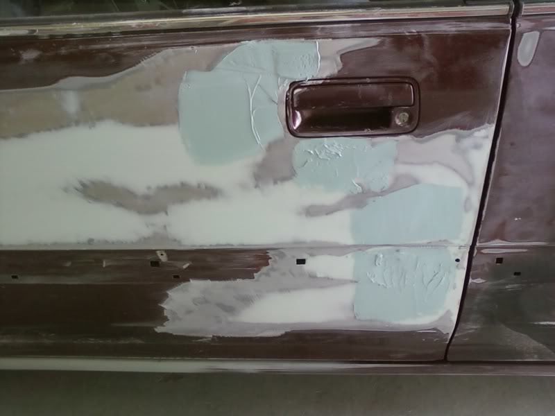

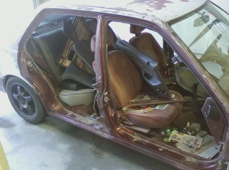

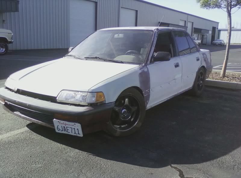

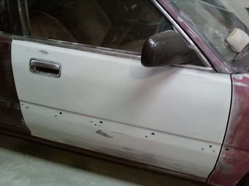

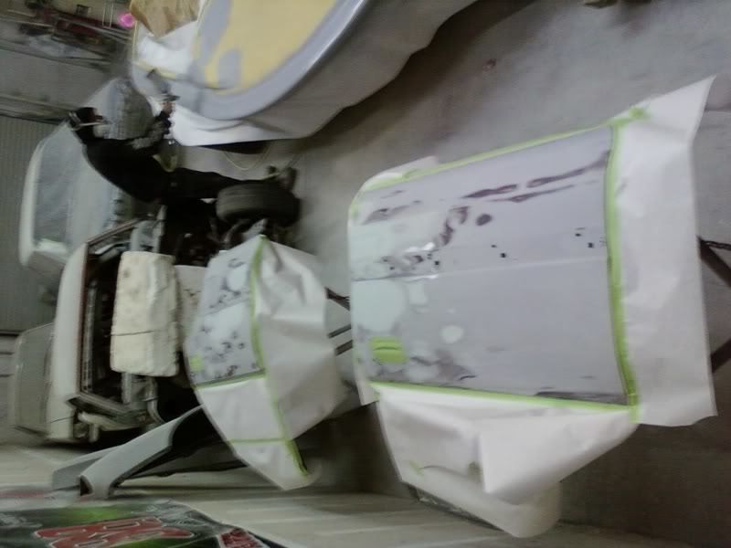

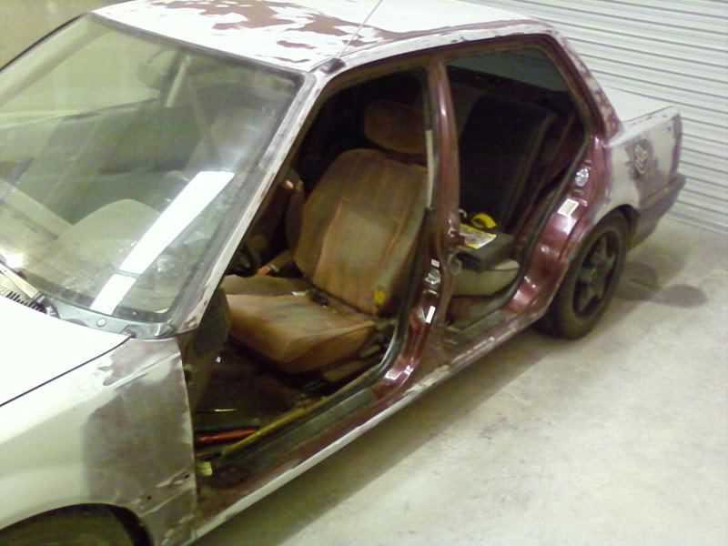

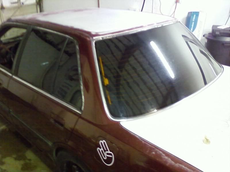

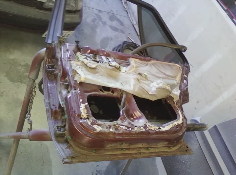

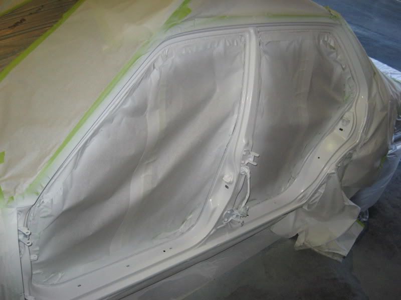

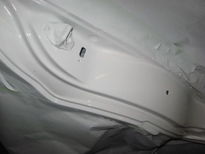

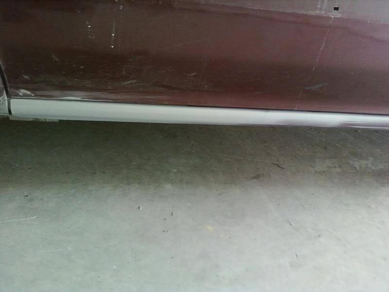

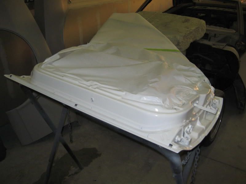

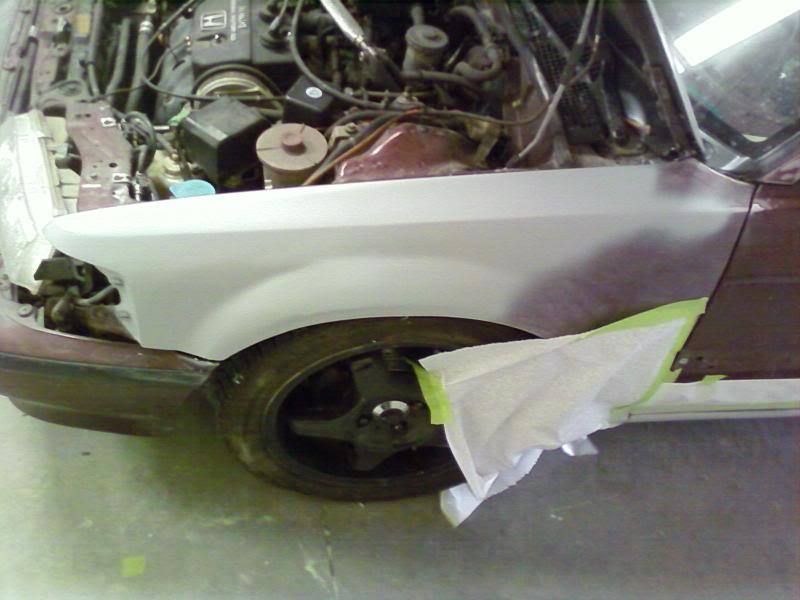

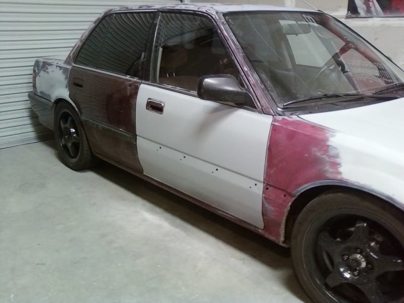

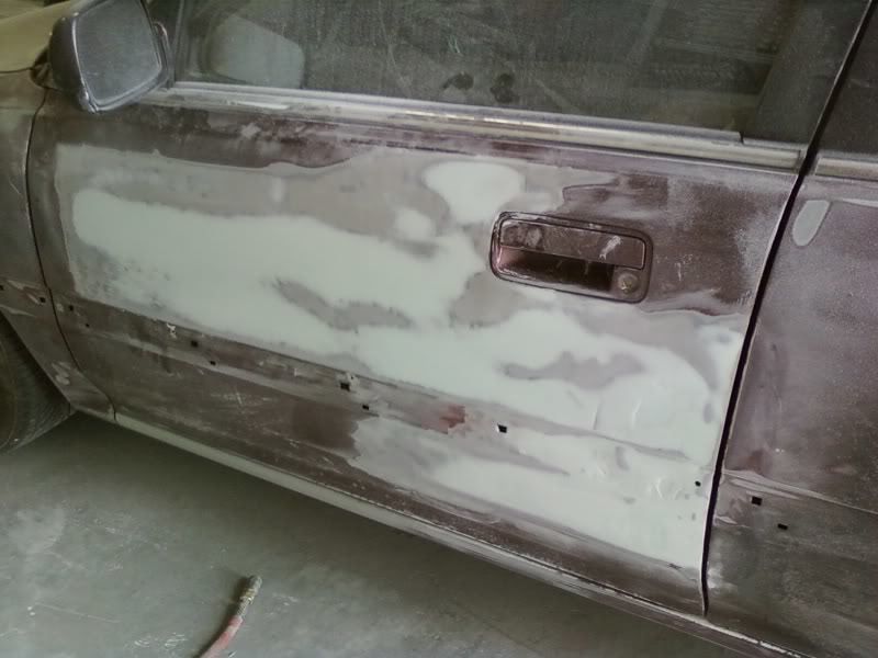

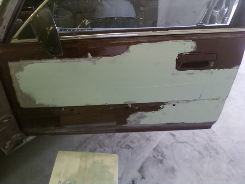

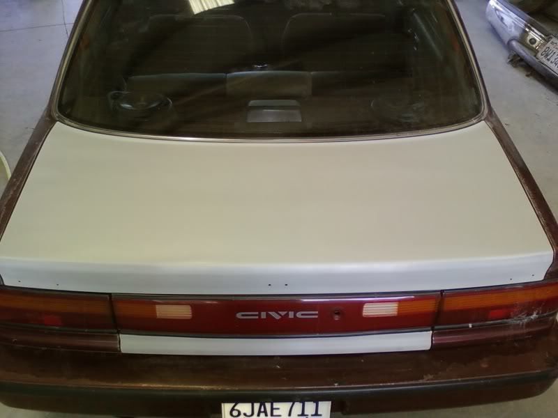

Got to work on my car this afternoon, Pretty positive I got my passenger front door damn near perfect, I need to prime and block it, I guide coated the filler and everything came out really nice, We'll see. Now I got my last door the toughest of them all, We'll see how it goes lol. Heres some pics how it sits now..

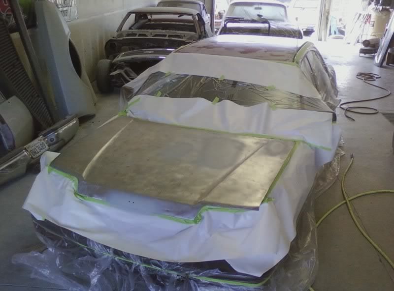

The cadi in the background, we just got done painting, Dude got it for 4k at an auction, Had a wrecked front end. we fixed it and painted it, You'd never even know.

Ill post pics tomorrow after its wet sanded and buffed in the sunlight, the yellow has yellow pearl the orange is lamborghini orange the blue is a sapphire blue effect (my boats paint) I let him use some lol
elbine69's avatar
elbine69
Paint on the boat looks good! Not sure how I feel about the overall color scheme though. Idk if you mentioned it, but what color is your car getting painted?
slammedyota91

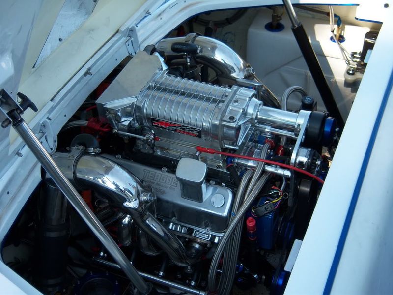

Mine is going to be Bright white, with White pearl. Gonna look suweet. and I dont like the scheme either but in person it looks tits. The paint scheme is the original scheme but we fixed all the cracks and the chips and repainted it with all way better paint and colors, its a Hondo dragster v-drive. Its getting a blown 454 completely built. It should hit about 117mph on the water
